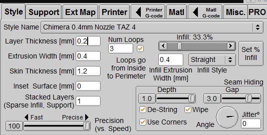

Re: KISSlicer 1.5 release candidate 1
What version of Windows are you guys running with the erroneous numbers appearing in the fields? I'm running KISSlicer Win64 on Windows 8 and I'm not seeing any erroneous numbers:
I was going to upgrade to Windows 10, but might hold off if that creates the issue.
